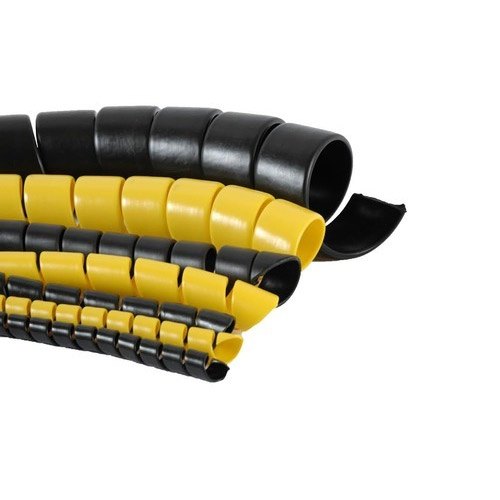

I do have some Monster plastic cable wrap like this:
(broken image: http://www.rubbersealstrips.com/uploads/140828/1-140RQI515B6.jpg)
But thinking this isn't going to offer any protection if it's even needed. Is what I'm doing a problem or should I not really see any issues with this? If I will, any suggestions for alternatives or other types of wires? Will be running basically 4 cat5 wires for a trunk between switches, 1 cat5 wire for the phone line running into the Comcast cable modem, and two coax runs, one to the cable modem the other to a media center PC recording shows.
