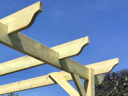

With the right hardware you can probably reuse the ledger. If it's fastened to the structure by an approved means (lag screws no longer qualify), and if you use joist hangers that don't require fasteners near the bottom, it should work fine.
One other strategy, if 2x6 joists are indeed adequate, would be to simply notch the joists so that the mount height remains nominal 2x6 size. This will not negate the stiffness benefit of the larger joist size. I would then run two 3" screws from below and just outside the notch to prevent horizontal splits there.
 __  _________________________
|__||__  :  :
       |_:__:_________________
Of course, you could always break out a jigsaw and put a nicer tapered, curved transition outside the notch to relieve stress, a la the boards on a pergola.

8
