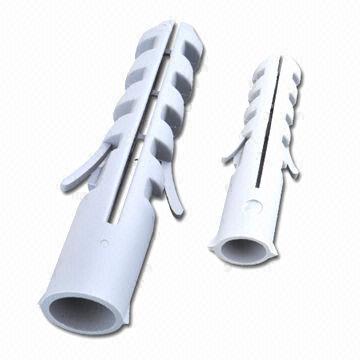

enter image description here Plastic Ankers work pretty well and can support the weight. Available in all Home Improvement Stores in different sizes
1
  • No they don't, plaster and lath walls, not approved for this use. May 30, 2021 at 20:57
