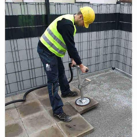

Just to add to the various hints, and complete the picture of available techniques, professionals who do this a lot would use a vacuum slab lifter, something like this:
Image from Express Tools
Source: Express Tools
However your surface area may be too small for this, but even smaller attachments are made for bespoke situations.
A bit much of a purchase for a one-off, but worthy of note for completeness sake!

    Might such a tool be available for rent? Jul 14, 2020 at 19:44
  • 1
    Yes: Major tool hire places might have it. Some come up in a web search. I just picked the one with a nice image Jul 14, 2020 at 20:07
  • I'd think your slabs would have to be pretty smooth in order to get an adequate seal with one of these. It does appear that the guy in your picture has wet them down to improve the suction, but I'm not sure how well even that would work on the rough bricks in the OP. Jul 16, 2020 at 13:27
  • Only a complete sucker would buy this.
    – Kaz
    Jul 16, 2020 at 22:07
  • @DarrelHoffman Also, that's going to suck up all the debris from the gaps between the pavers; how is the vacuum pump machinery going to like that?
    – Kaz
    Jul 16, 2020 at 22:09
