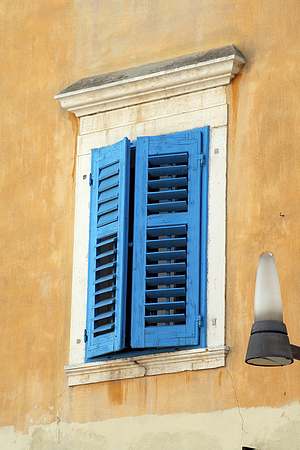

In many French buildings the windows open inwards so that you can have external louvred shutters closed with the windows open. That keeps the sun out whilst letting any breeze in. – RedGrittyBrick May 10 '13 at 23:42

First, try to prevent the sun from hitting the building in the first place. Shade trees, large overhangs, louvers can all do this. There may be micro louver screens available that appear to be heavy duty insect screens but are actually very small louvers. You can easily see through the louvers, but they prevent the sun from hitting the glass.
